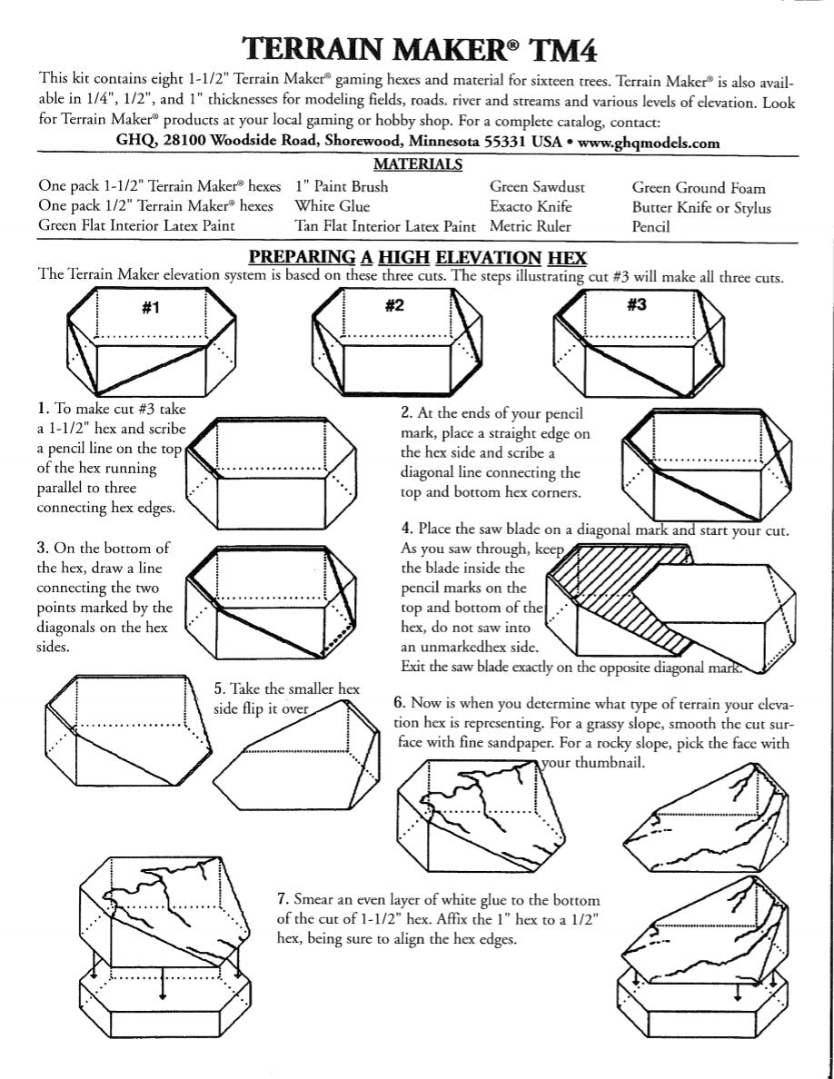

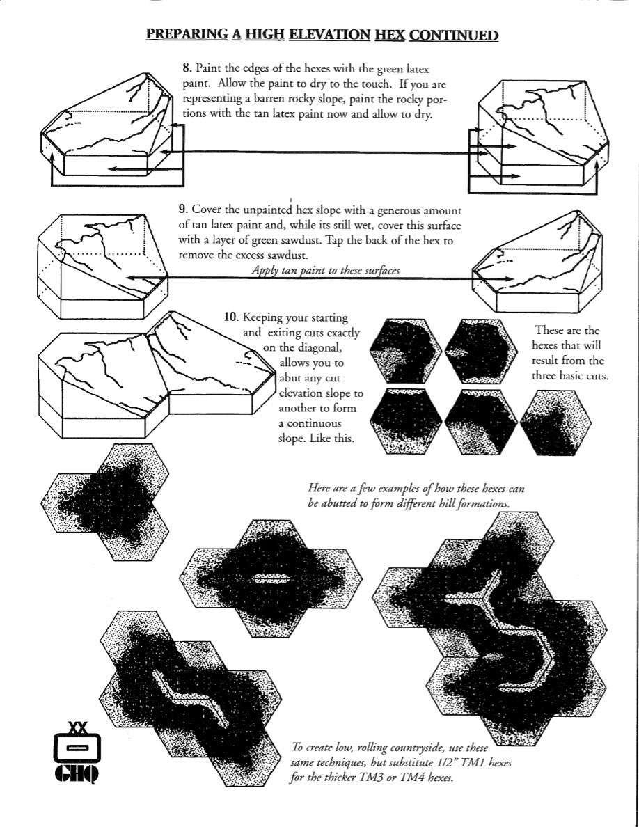

Terrain Maker® is a geomorphic wargaming terrain system based on double-density Styrofoam hexes measuring four inches from side to side (Terrain Maker hexes are 4" from the middle of one side, through the center of the hex, to the middle of the opposite side). The thickness of the hex determines the type of terrain it models.
Per pack: TM4 contains 8 hexes (each 1½ inch thick), enough tree material to make 16 trees, and instructions.
This is the standard mountain or level-2 Terrain Maker hex. Base TM4 hexes on TM1 ½-inch thick hexes—sold separately—then model mountains and steep elevations.
